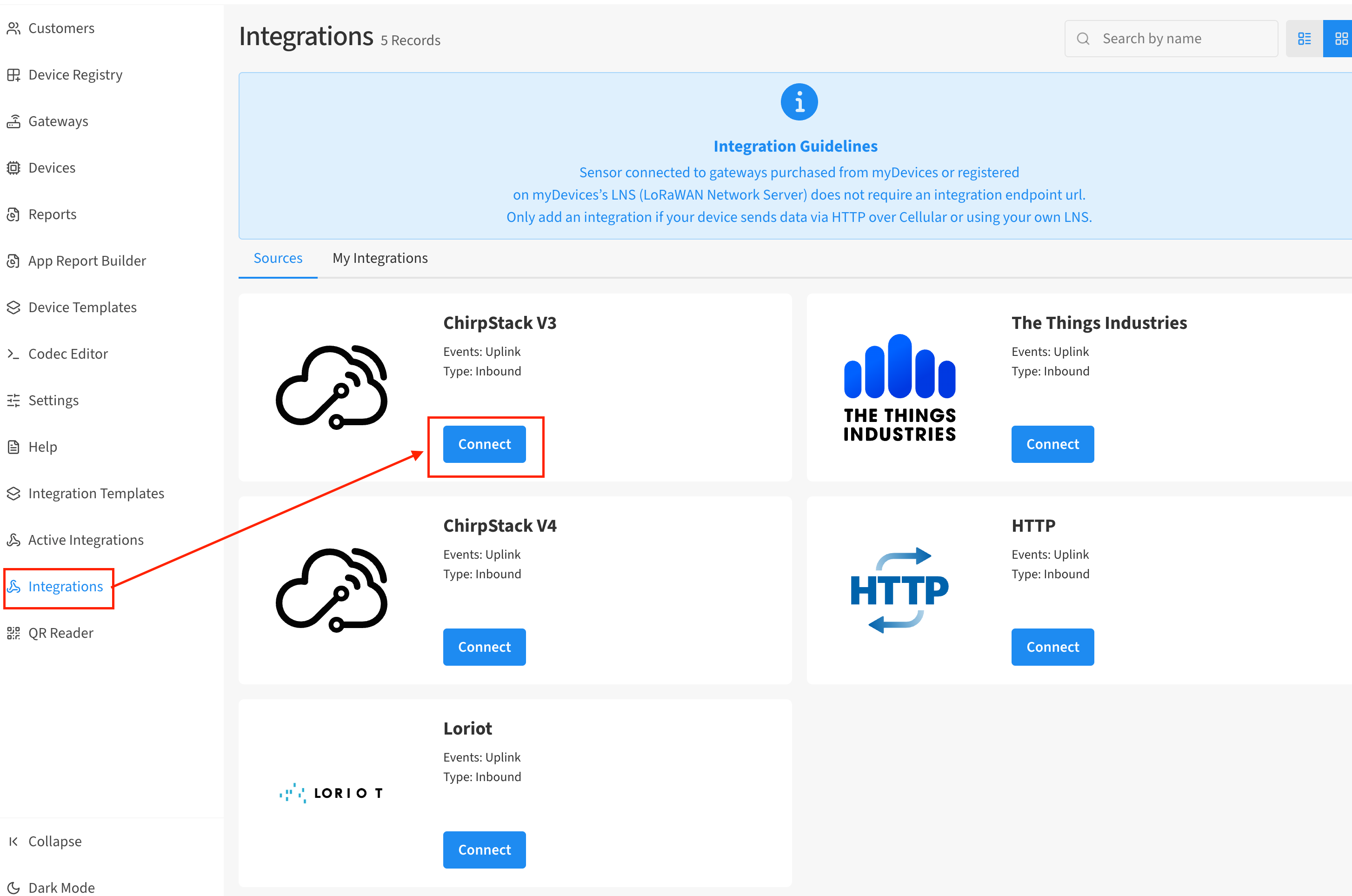

  1. Log in to the myDevices Console.
  2. Navigate to the Integrations section.
  3. Find ChirpStack V3 and click Connect.
    CSIOv4

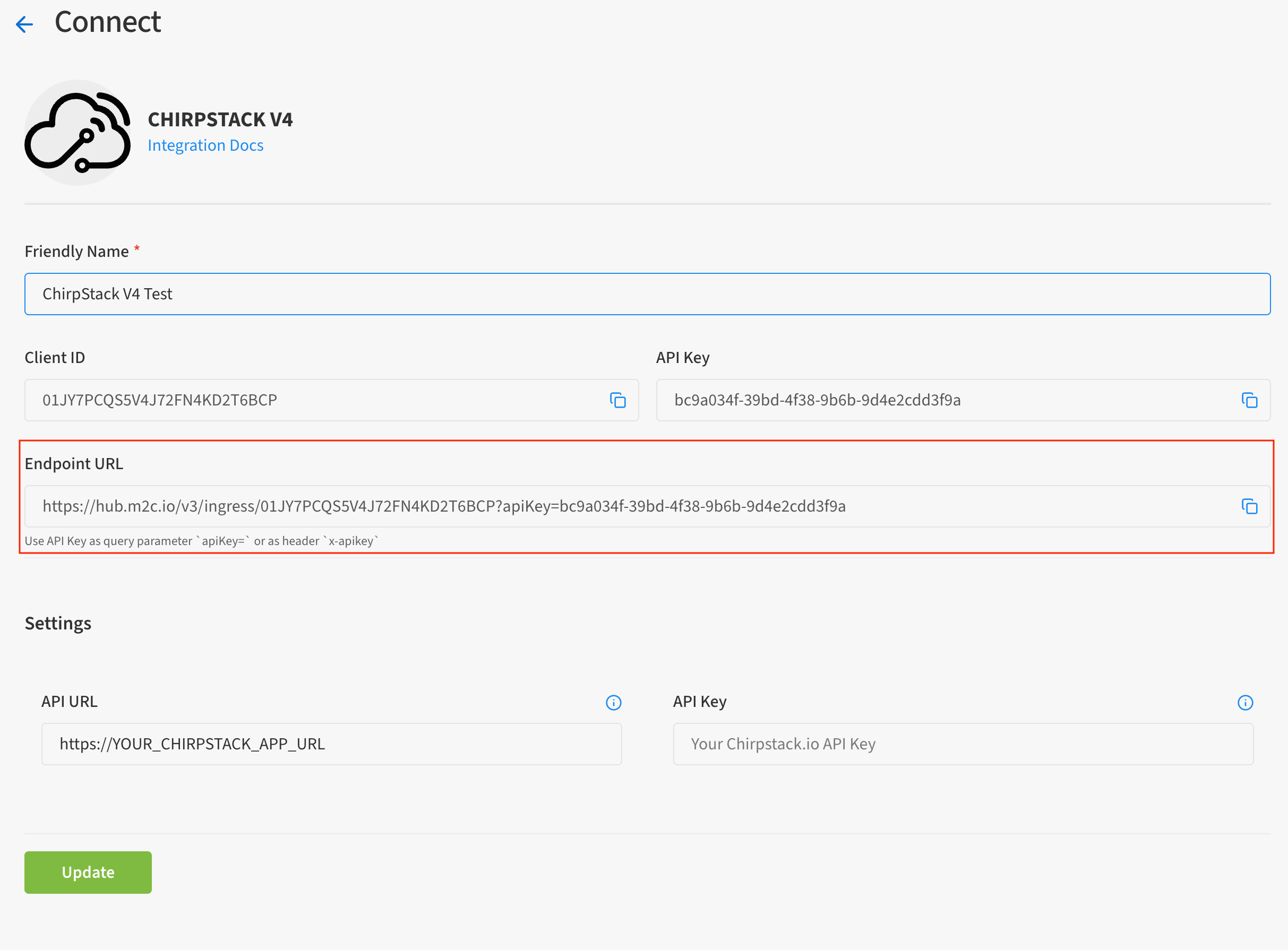

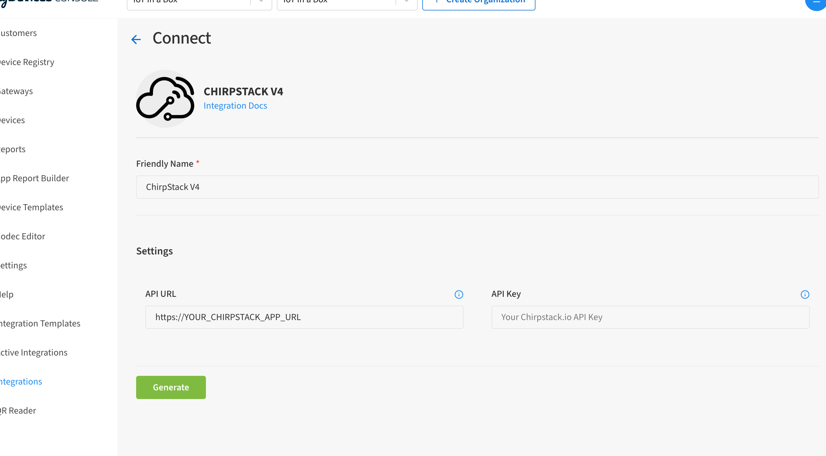

  4. Enter a name for your integration, your ChirpStack REST API Endpoint and API Key. This is needed for downlink support.
CSIOv4 Settings
5. Click "Generate" and copy the **Endpoint URL**
CSIO Setting View

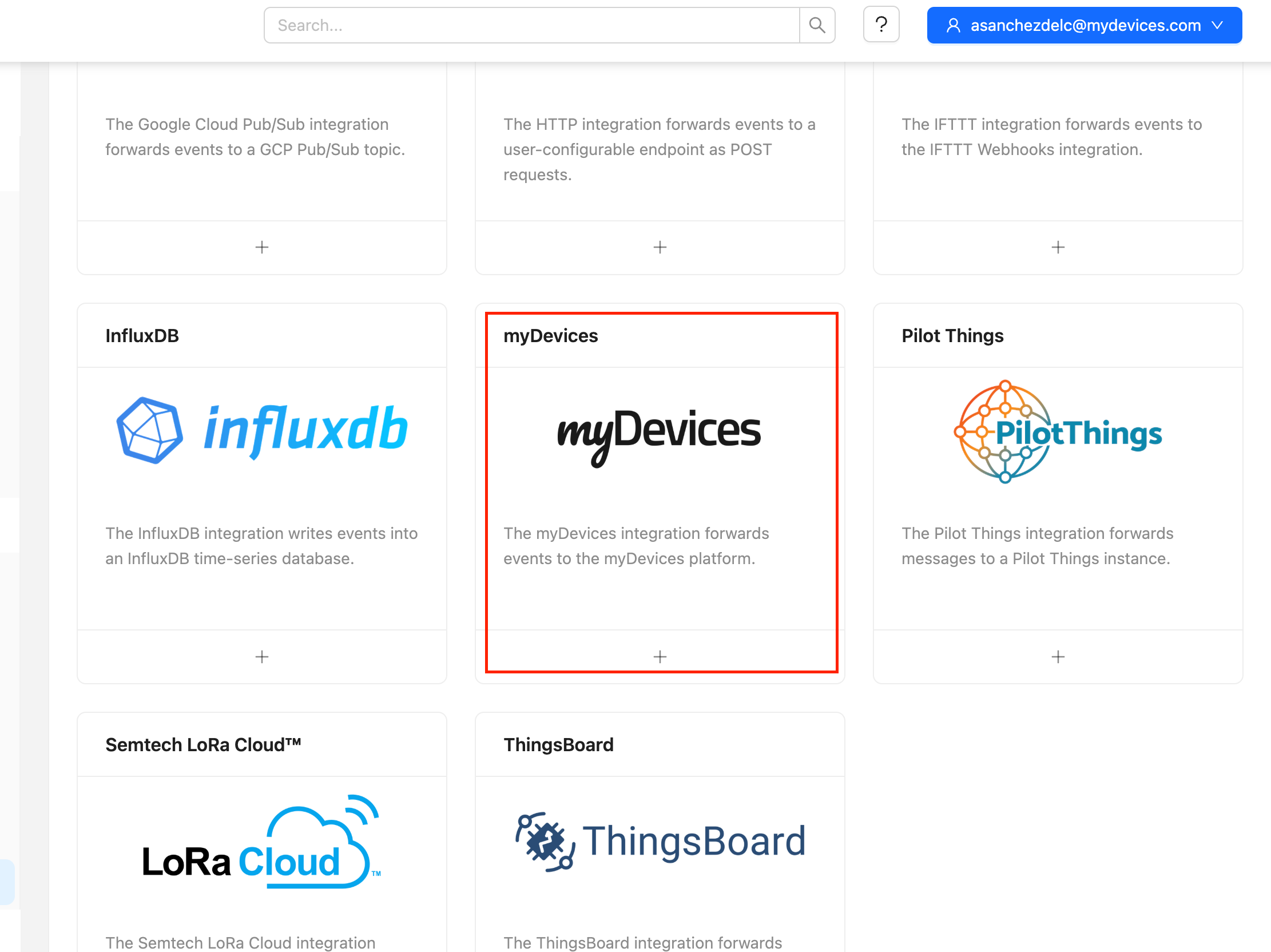

  1. Login to your Chirpstack Portal
  2. Select your Application and navigate to Integrations
    myDevices CSIO

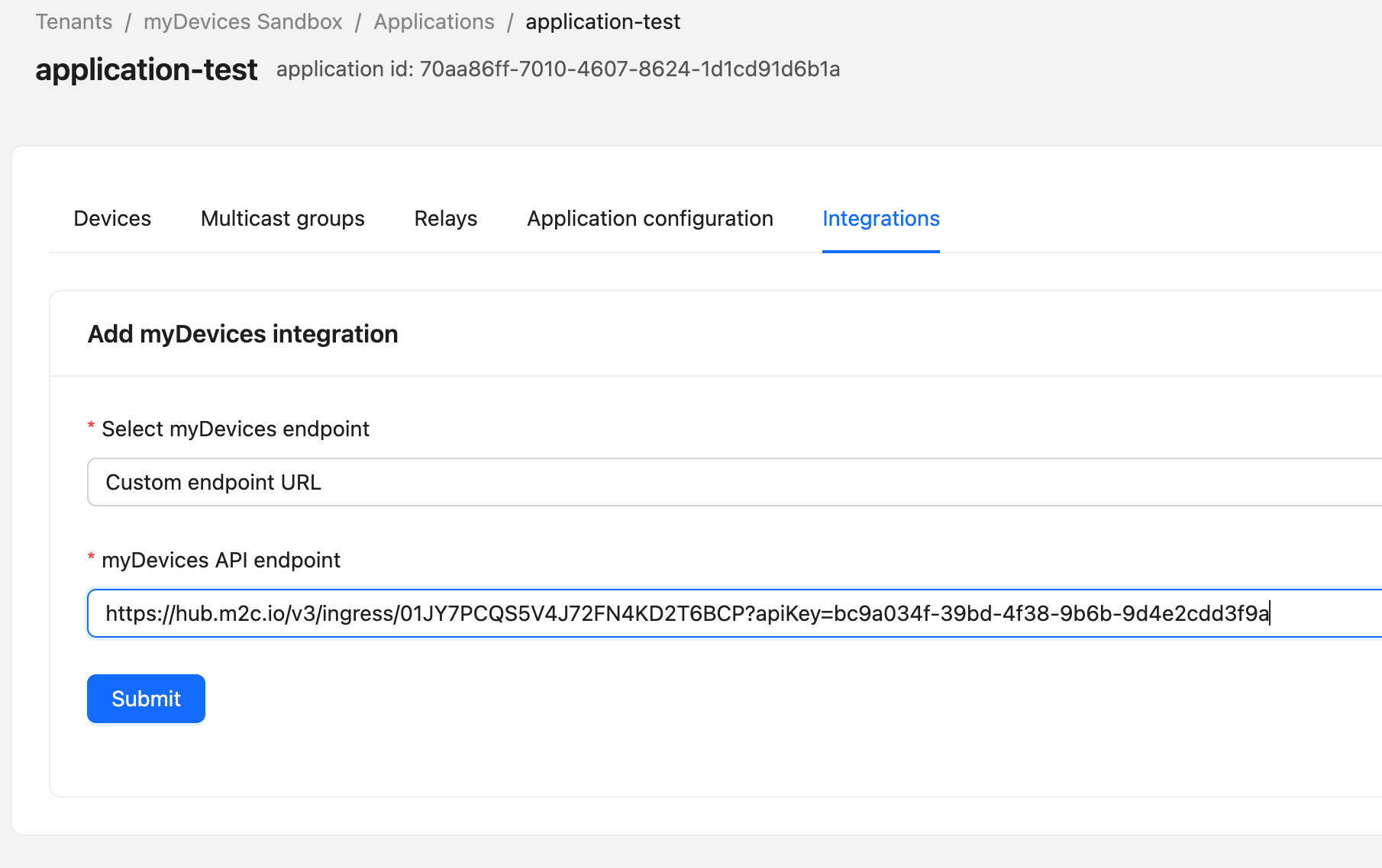

  3. Pick the Mydevices Integration and in the dropdown select "Custom Endpoint"
    myDevices Integrations
  4. Click "Submit".
